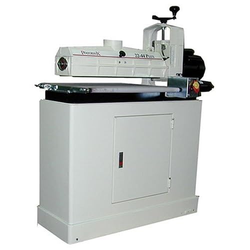

PostPosted: Sat Jan 26, 2008 9:26 am
Posts: 8556
I have the 16-32 and have used it from my second guitar until present.
It is adequate.
That said, had the 22-44 been available at the time I would have sprung for the extra cash.
